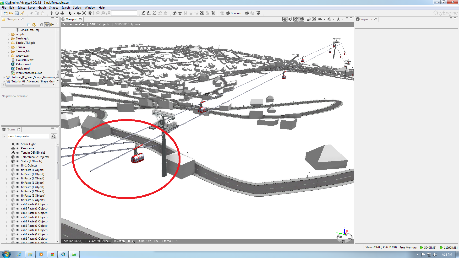

Well, I tried manually but as you could see in the picture I couldn`t connect them manually ( because the cable is thin and between 2 pools there is a different height, rotation and etc...

Use these tools to move, rotate and scale the OBJs to fit between the poles:
This is easier than writing a rule, unless you need to model cable cars very many times.
You might try moving and scaling before rotation, since rotation makes the scaling harder.

I used those buttons ( scale,move and rotate) but those cables are very thin and it's difficult to connect them at pools....

Maybe try drawing 2 very thin streets - one for each continuous cable. Put the graph nodes where you want the lines to connect to the towers. Positioning the nodes should be much easier than placing the OBJ. If you can get that set up then we can do a rule for the cable insertion.
There is no existing way to run this as a single street rule. There could be if someone wrote a Py script to generate custom shapes on the graph. Possible, but difficult.

I already have a line feature class which vertexes are snapped to the points that are the towers ( practically in city engine the graph`s nodes are connected to the towers).
We are working one a way to solve this problem( creating a rule or so) before taking the manually solution....so we`re open creating a rule for this !
