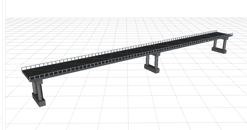

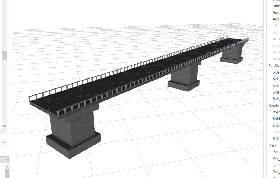

I'm fairly new to CGA, but I want to modify the existing rule package, so the pier style would be based on attribute data. The rule packages is originally from 3D Basemaps Solution. Currently, the only options for pier styles are "Solid", "2 Pipes", "3 Pipes", which means that throughtout the bridge, the shore and river piers stay the same style. However, based on my attribute data, the shore piers can be solid, but the river piers can be "2 Pipes" and "3 Pipes". How do I modify the rule package in a way that the inner and outer piers are different?
For example, in this picture, all the piers are solid.
And in this picture they are "2 Pipes".
I need to combine those two styles, so that the middle pier is "2 Pipes" and the end and start piers are solid blocks.
