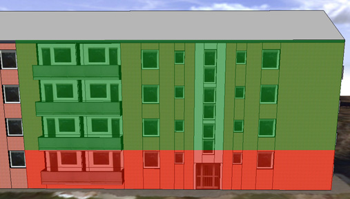

I created a building using vertical splits because some elements (the entrance part) didn't line up with the rest and to keep the number of splits to a minimum. However, now I'd like to split the building horizontally to color its floors separately. Is that possible while retaining the current structure?
Here's a photoshop mockup of what I'm trying to do:

Here's one way to do it:
version "2014.1"
attr floorCount = 4
attr floorHeight = 4
Shape -->
  extrude(floorCount * floorHeight)
  SplitIntoFloors
SplitIntoFloors -->
  split(y) {floorHeight: Floor}*
Floor -->
  comp(f) {side: Facade(split.index)}
Facade(floorIndex) -->
  case floorIndex == 0: color(1,0,0) FacadeVerticalSplits(true)
  else: color(0,1,0) FacadeVerticalSplits(false)
FacadeVerticalSplits(isGroundFloor) -->
  split(x) {
  '0.4: VerticalSplittingLeft |
  '0.2: EntranceOrWindows(isGroundFloor) |
  '0.4: VerticalSplittingRight
EntranceOrWindows(isGroundFloor) -->
  case isGroundFloor: Entrance
  else: EntranceWindows
Entrance --> YourOldCodeHereForGroundFloor.
EntranceWindows --> YourOldCodeHereForWindowsAboveEntrance.
VerticalSplittingLeft  --> YourOldCodeHereForLeftSide.
VerticalSplittingRight --> YourOldCodeHereForRightSide.

But if you do it that way, you must be OK with the vertical section over the entrance being slightly different as in below image:
LR
Hmm that's what I wanted to avoid.. but I guess it's probably better to just rewrite the script and do the coloring like in your example. Thanks!
