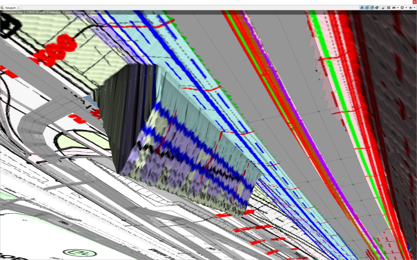

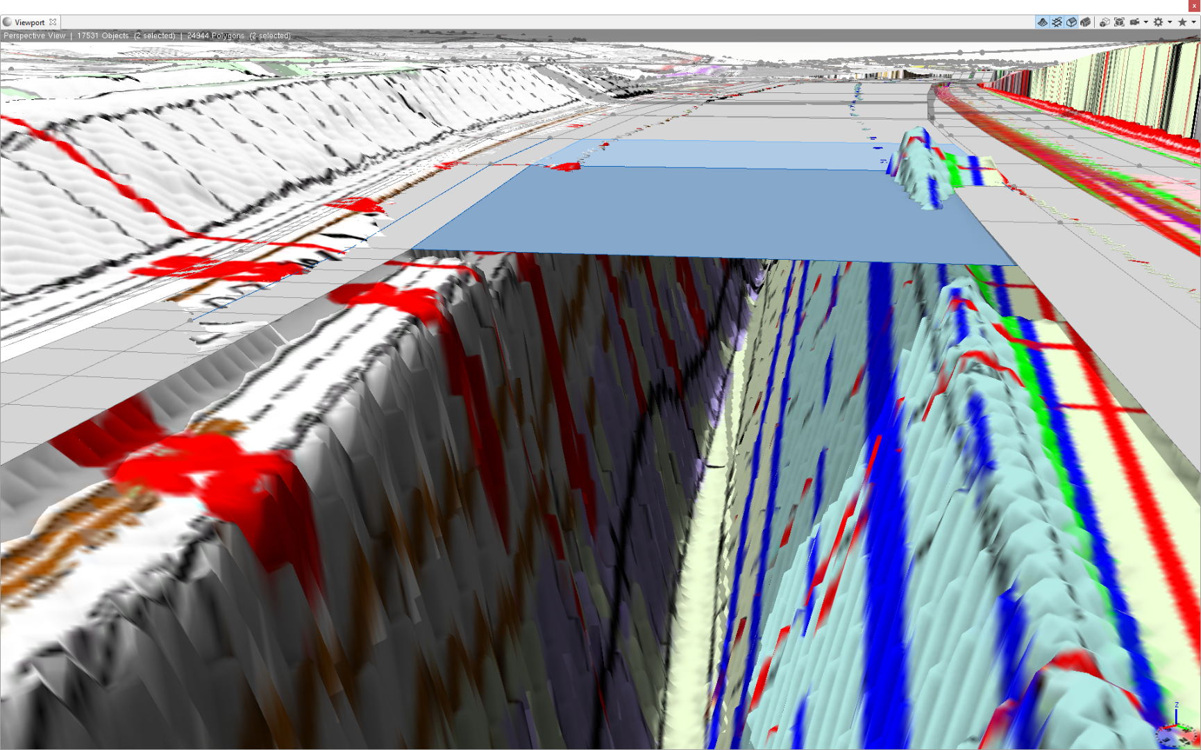

I'm trying to flatten a small hill using a street. However when I run the align terrain to shapes tool, it just punches a chasm in the raster far below the shape. Changing the maximum distance unfortunately only influences to depth of the chasm but does not prevent it. What's the cause of this?

It just randomly started after a while but when it occurs once it always happens. It doesn't matter if it's streets or polygons. What helped (at least sometimes) was creating a new project and then importing the layer from the new scene. It also seems that using smaller (about 1m²) polygons reduces the chance of this occuring.
I had the problem in 2016 and 2017. Can't share the project but I'll see if I can replicate the error with a smaller sample when I have the time.
