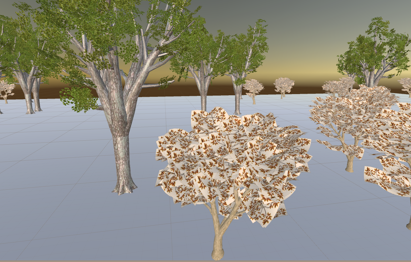

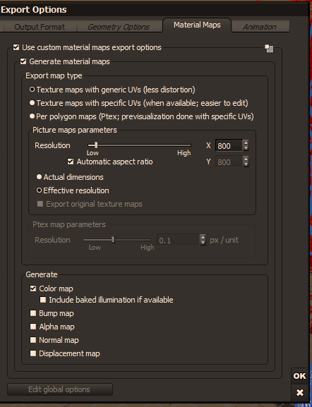

Plant loader with LumenRT is a great resource for visualizing plants, but for even more extreme scientific usage, I would like to include more species to visualize. Seems there's few free 3d tree model online. The approach I'm trying now is to export 3d models from another 3d modeling software I have, but because of different texture formatting with LumenRT library, the leaves texture is not showing up correct (fig.2). Seems to require fairly amount of photoshop. Does anyone know how to adjust the texture map export setting (fig.2) or incorporate customized tree models to the LumenRT library?
fig.1
fig2

Your leaf textures are lacking transparency, try generating an alpha map.
awei
On that one screenshot there was no alpha map, but I did generate alpha map. Just try again, with alpha map, the leaves still don't have transparency..
LR
Can you post the original model?
awei
If other people have similar question, xfrog and Turbo squid are good places to find plant models!
CherylLau
What is in the .mtl file?  What should the tree look like?  Can you post the model (eg. .obj, .mtl, and related texture files)?
