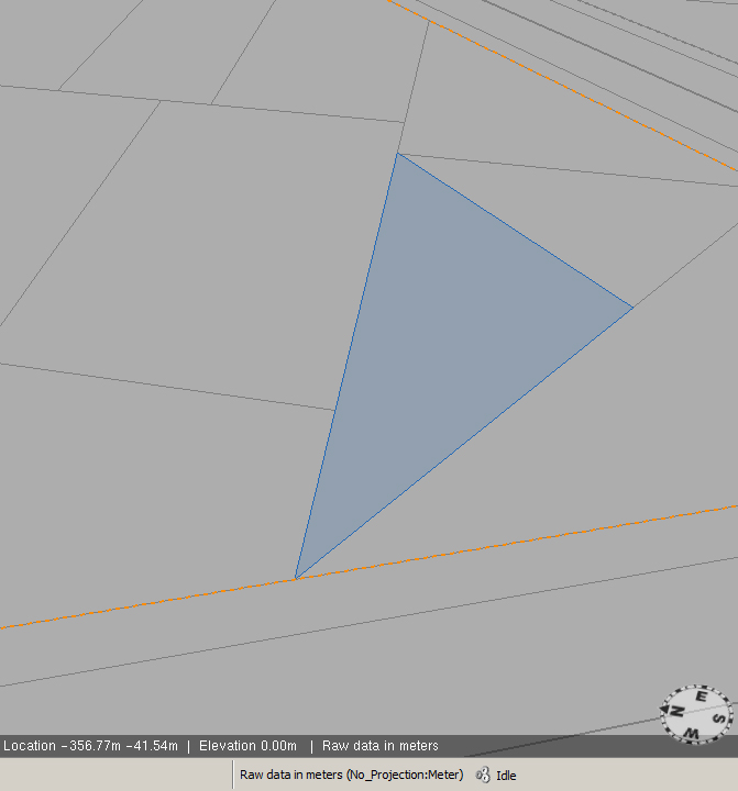

Is there a way in CGA code to check if a 2D scope contains any acute angles?  The reason I ask is that I don't want to generate a building on any lots with acute angles (generate a Park instead maybe).  I can check for 3 sided lots and rule them out, but it doesn't help with cases like this . . .
. . . .where there are 4 verts and 4 'sides' even though 2 of the sides are co-incident.  Checking for an acute angle would solve this, as there are 2 acute internal angles.  This strikes me as quite a basic thing to want to check for, before generating a building.

I don't have an answer, but I do have a theoretical question. I like questions that are hard to solve with a computer, but easy for a human eye to see. My question is, "what makes a lot un-buildable, and more suited for a park?"
I have had the same question on numerous projects. It can't just be "is an acute angle present". It would have to involve scale also. If the triangular shape you have highlighted was 200m long vs 20m, it would be able to build a small business park, vs no building at all.
Here's some lots that are adjacent to a railway, which could all take buildings, if wide enough (a function of scale, rather than angles):
Just curious about what other factors would be part of an "isLotBuildableOrPark" function... it would be good to define this, for general use in urban planning rules.
