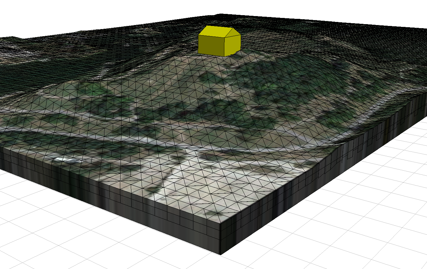

I played around with making a solid terrain a while ago, this was my rather janky result. The basic idea was to triangulate a shape then align it to the terrain, grab the lowest part's y-pos and subtract the current part's y-pos + x to extrude downward. Top it off with a thick plate from below and then slap an aerial image on top of that. If someone wants to know more, I'll try to remember the steps
