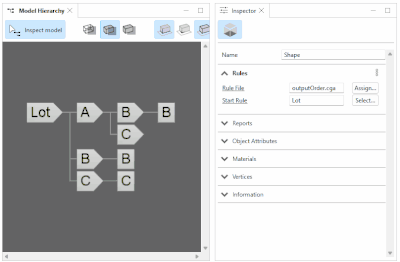

Let's look at the console output
1st
2nd
3rd
4th
5th
4th
5th
The console output from CityEngine looks like this

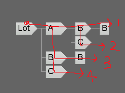

The output is not what I expected.

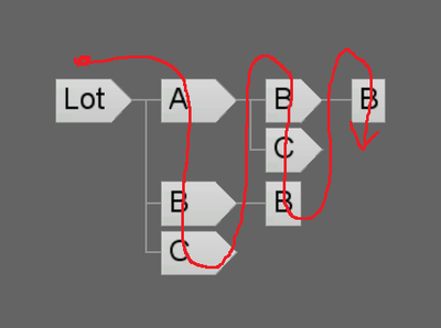

Here's what I expected to see
1st
3rd
4th
5th
2nd
4th
5th

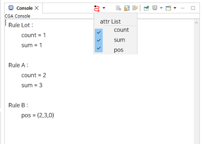

Also, I would like to see an "attribute value trace" button in the console window so I can see how the values of the declared variables are changing over the course of the rule.

Regarding the console output order:
While it is guranteed that always the same shapetree (which you see in the Model Hierachy) is generated, no particular order is guaranteed in which the print output of the rules appear in the console.  What you see in your nice picture is a breath-first order; your expectation is depth-first. None of them is right or wrong. In general you can not rely on a particular order here, in some situations (such as occlusion handling) this order might change.
Regarding "attribute value trace":
This is already possible. When you click on a specific shape in the shape tree of the Model Hierarchy a table of all attributes/values that the shape at that point has is displayed in the inspector:
Best,
