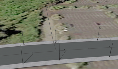

Thanks for the clarification. You are pointing out, that the necessary creation of the connecting node to the street network, does influence the initial shapes for the model generation. In the example below, the result is an altered lantern placement.
