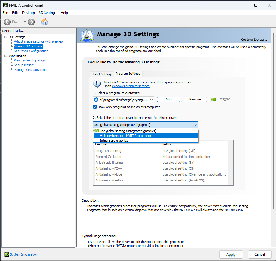

NVIDIA:
(For Windows 11 installation, follow AMD process below)
  1. Open the NVIDIA Control Panel
  2. Click on "Manage 3D settings"
  3. Now you can either change the usage of which graphics card to use
    1. Go to the "Program Settings" tab
    2. Click the "Add" button
      1. Select "CityEngine Application" from the Recently used applications
      2. If not available, manually browse for CityEngine.exe in "C:\Program Files\ArcGIS\CityEngine2024.0\CityEngine.exe"
      3. In "Preferred graphics Processor" select "High performance NVIDIA processor
Note: you can also use your NVIDIA card for all applications (global setting). Be aware that this can decrease battery life significantly.

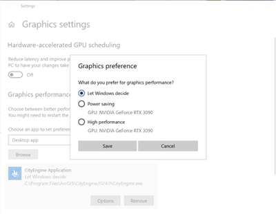

AMD:

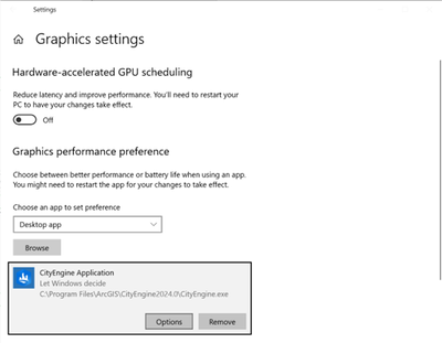

  1. Go to Windows Settings
  2. Search for "Graphics Settings"
  3. Choose "Desktop app" and browse to C:\Program Files\ArcGIS\CityEngine2024.0\CityEngine.exe
    (Or wherever you installed CityEngine)
  4. You should see CityEngine below, Click on "Options"
  5. Select High performance (should display your AMD graphics card)
  6. Restart CityEngine

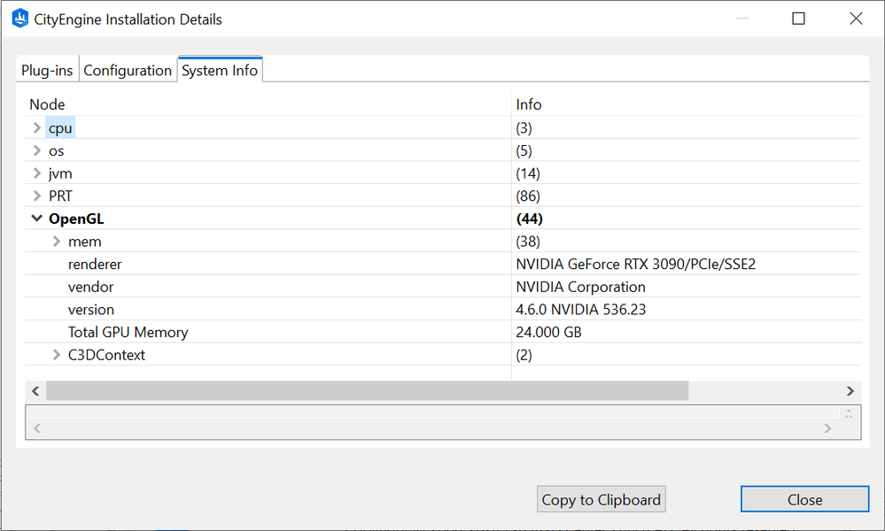

Verify CityEngine is using the correct graphics card
  1. Open CityEngine
  2. Open any Scene (can be an empty new one)

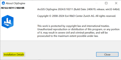

  3. Go to Help > About CityEngine
  4. Click on "Installation Details"
  5. Go to the "System Info" Tab and expand the "OpenGL" section
  6. Under "renderer" you should see the graphics card CityEngine is using:

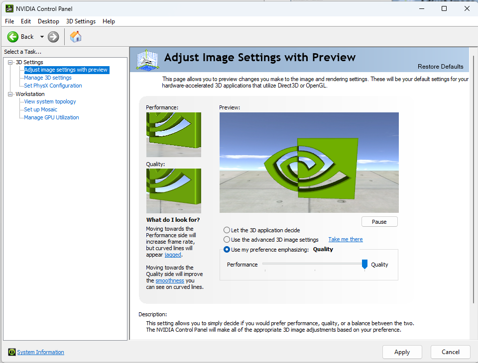

Easy Option (Will affect rendering in other Applications!)
  1. Open NVIDIA Control Panel
  2. Switch to "Adjust Image Settings with Preview"
  3. Select "Use my preference emphasizing"
  4. Drag Slider to the right until it says "Quality"
  5. Hit "Apply"

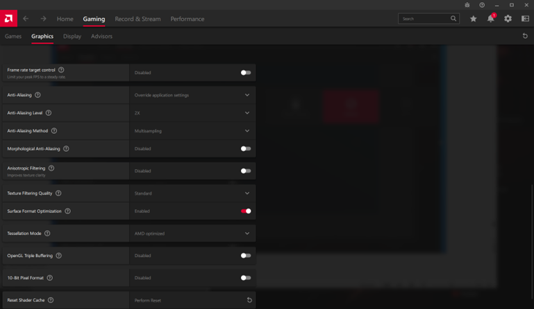

AMD:
  1. Open AMD Software: Adrenalin Edition™ Application
    (if not installed, get it from here)
  2. Go to the "Gaming" section
  3. Go to the "Graphics" tab in that section
  4. Scroll down to "advanced" and expand it
  5. Change the following settings:
    • Anti-Aliasing: "Override application settings"
      (Will enable anti-aliasing. This feature smooths out jagged edges in the rendering)
    • Anti-Aliasing Level: "4x"
      (increases quality of anti-aliasing)
    • Anisotropic Filtering: "Enabled"
      (will provide better texture clarity at shearing viewing angles)
    • Anisotropic Filtering Level: "8x"
      (increases quality of anisotropic filtering)
  6. Close AMD Software and restart CityEngine
