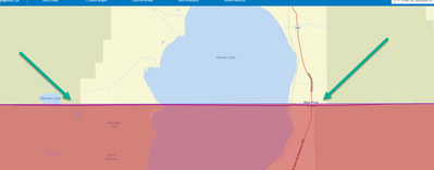

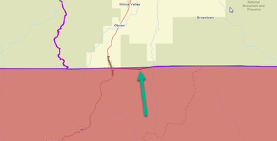

@ArielLow2146 Thank you for providing your sample data. When comparing the areas in the sample data to the standard geography for California, I'm seeing a very slight overlap into California. This slight overlap is what is causing the infographic to include California in the comparison drop down.

@ArielLow2146 For the California border, I used standard geographies available through Business Analyst which are based on US Census boundaries. I used the Select Geography workflow to create a site of California then compared to your layer on the map.
