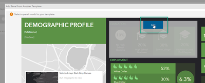

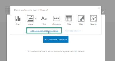

Hello @ColinMcNamara,
Unless I'm missing something in your workflow, it seems like this functionality is still there and you should be able to add interactive panels from exiting templates.
Step 1:
Step 2:
Step 3:
Let me know if this is not working for you.
Thanks,
Fasil T.

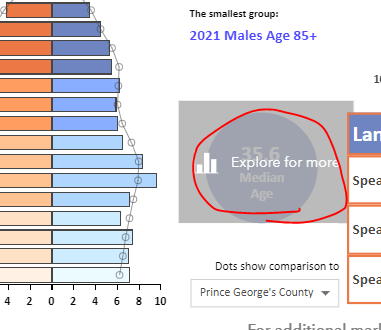

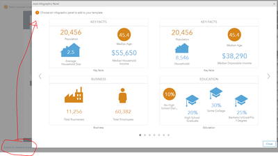

ColinMcNamara
Hi Fasil,
I am trying to select just the panel being used in the "explore more" section of an infographic panel, not the entire panel.

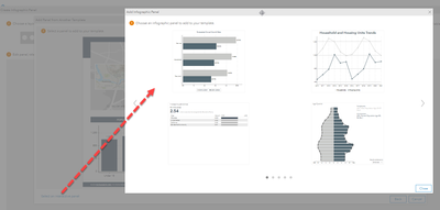

FasilTiru
Hi Colin,
You are absolutely right. Adding interactive panels from exiting templates is not working right now. But the good news is that this bug is already fixed in the upcoming release (end of March).
Here is an example that shows the gallery of all interactive panels in the  At Risk Population template.
Good catch and thanks for reporting!
Fasil T.
