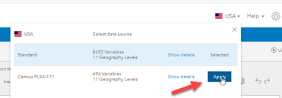

The "what's new" states that 2020 redistricting data is available for infographics and classic reports, but I can't find it.  Am I just missing something?  This would be really helpful for our reapportionment efforts.

Please follow these steps to access the PL94-171 data, infographics and report:
  1. Click on the country picker (flag) at the top right corner of the app.
  2. Find USA and click on the gear icon
  3. Here you can pick between the Standard and Census PL94-171 datasets. FasilTiru_0-1644613217490.png
  4. You will find the report and infographics there.

BobbiLay
Perfect!  Thank you.
