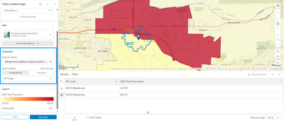

1. You can learn about geographies within a certain area by using one of our workflows that has the Results pane - Color-coded maps, Smart map search, Benchmark comparisons or Suitability analysis.
For example, with Color-coded maps, you can input your drive time Site as the Area of interest and then select Zip Codes as the Level of detail. If you go to the Table tab of the Results pane, you can export the list of geographies.

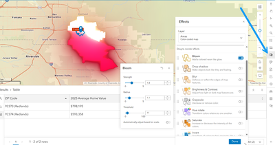

2. Within the Data browser, there are options for variables that can show property value. For example, Average Home Value. After creating a map, you can explore the new Effects tool to style the map how you would like. The Effects tool can be found on the right side of the app in the palette.

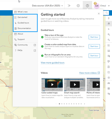

I hope these details help you continue with your work and to explore the options available. Be sure to check out the resources we have in the Help menu too! Thank you for reaching out.
