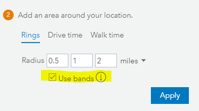

Based on your description, I think you forgot to select the "Bands" option when you created your drive time areas:
In the screen capture above, the bands option creates areas from 0 - .5, .5 to 1 and 1 - 2.  Without the bands option, it creates the areas from 0 - .5, 0 - 1 and 0 - 2 and there will be overlap that will then get carried into the intersect process.

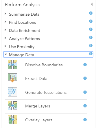

Let's say the green outline is a zip code polygon and the purple line is the border between two drive time areas.  Because the intersect overlay is going to "cut" the green polygon by the purple line, you will get multiple pieces of the zip code in the "northern" part of the drive time area and a single zip code polygon associated with the drive time area in the southern part of the image.  This is exactly what we would expect the software to do in this case, but we would really want the two "upper" polygon pieces to be merged into a single polygon. While you can do that with a "Dissolve Boundaries" tool in ArcGIS Online, you may want to simply use a pivot table in Excel to combine the zip codes into a unique list for each drive time area.
