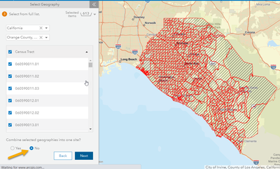

Thank you for confirming @SilverstonePartners. Here are a couple options to consider for downloading data using BA Web App. Please let me know if these details help to answer your question, or feel free to explain your goal further.
  • Create sites to use for running reports
    • You can create sites based on a point, based on standard geographies (like block groups), or hand draw an area. Please see the Create sites resource for details.
    •  Example: Use Select Geography workflow to create sites for each census tract in a specific county.

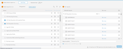

  • Create Comparison reports
    • After creating your sites, go to Comparison reports to display data for the areas. Use the drop down for Esri report templates. You can also export the data to Excel immediately.
    • With Comparison reports, you have the ability to create your own custom list of variables to include in the report. Just use the option for +Create new report and use the Data Browser to create your custom list.
  • Create infographics and reports
    • With a Standard license, you can also use premade templates that are available for infographics and reports. Classic reports are helpful for exporting larger amounts of data to excel for a particular site or area.
SilverstonePartners
HI Cheryl,
You replied to this awhile ago but I've just had a chance more recently to fully explore.  What you suggested worked, however am I limited to 100 records, i.e. 100 Census Block groups?  Is there any way to expand this?  I tried this with Travis County in Texas, and there were 700+ block groups but the downloaded excel only had 100 records.
CherylHagevik
Hi @SilverstonePartners With the Comparison Reports workflow, you should be able to add up to 1000 sites and then export the data to Excel. Canyou please confirm if you were working with Comparison Reports and if so, how many variables did you add to the report with your 700+ sites?
SilverstonePartners
@CherylHagevik  - thank you for reply.  You are correct.  I had not selected the right sites.  Problem solved - all good from my end!
