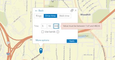

CherylHagevik
Thank you for clarifying @Virginie_Chevalet. Yes, there are limits to the size of service areas that can be created. These limits are outlined in our documentation and can also be seen directly in BA Web App when creating the areas. Please see below.
Create sites - Place a point on the map
