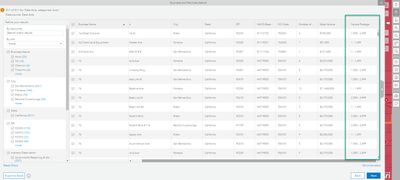

@JohnWaterman With the latest release, the Square Footage field is now available in Business search results as follow:
Fasil
BA Team
