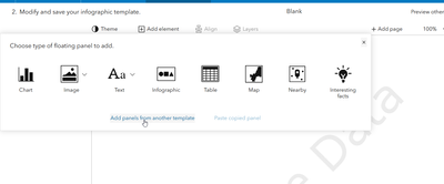

Hi @LoriHatfield1 Thanks for reaching out with your question. When adding a custom variable to infographic and report templates, the GUID for the custom id is assigned when you add the variable to a template. If you would like the id to remain the same between different templates and are using the same panel/element, you can use the option to Add panels from another template, then the id will carry over to the new template.
If you are not using the same panel/element between templates and need to add the variable in a different design format, then it would receive a new id. You could work around this by manually editing the ids in the metadata of the template. Please let me  know if you would like to learn more about this manual editing method. However, please keep in mind editing the files directly would be a workflow you could perform at your own risk. Hope this helps!
