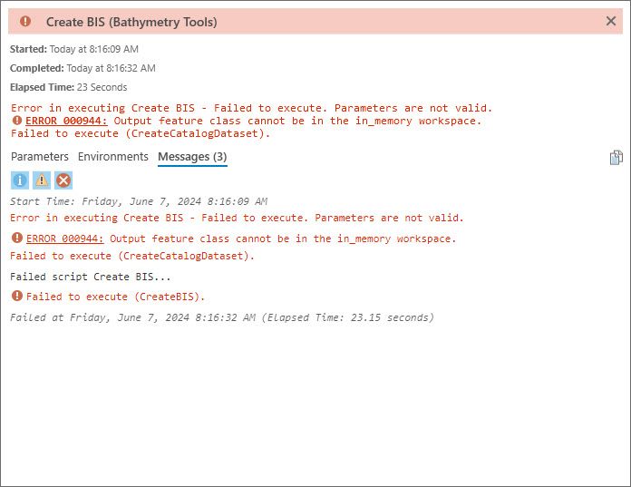

I am trying to Create BIS (Bathymetry Tools) and continue to receive this error "Error in executing Create BIS - Failed to execute. Parameters are not valid. ERROR 000944: Output feature class cannot be in the in_memory workspace. Failed to execute  CreateCatalogDataset)." I have tried changing my Proxy Raster Location to various locations and nothing seems to work. I have created new folders for this in various locations and no change to the error message, I can't seem to get it out of an in_memory workspace.

RollingsSJ
I have ArcGIS Pro3.3.0, as far as I can tell I have the newest version of ArcGIS Bathymetry. I am using a file geodatabase.
MeredithPayne1
Please attach the message log text that the Create BIS tool is generating for me to take a look at.
RollingsSJ
MeredithPayne1
We have found a bug in the Catalog Dataset tool that prevents adding items to a catalog dataset if the workspace is a drive starting with the letters I-Z. Although I cannot see the parameters from the view you provided, is that the case for you? If so, you should be successful if you remap your drive name to a letter A-I.
