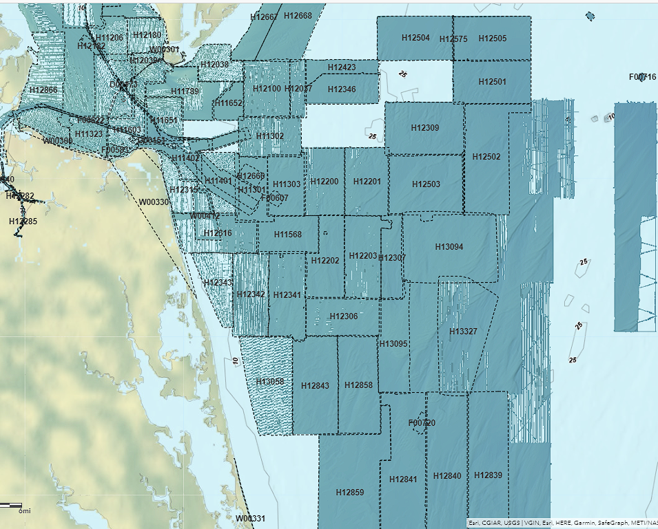

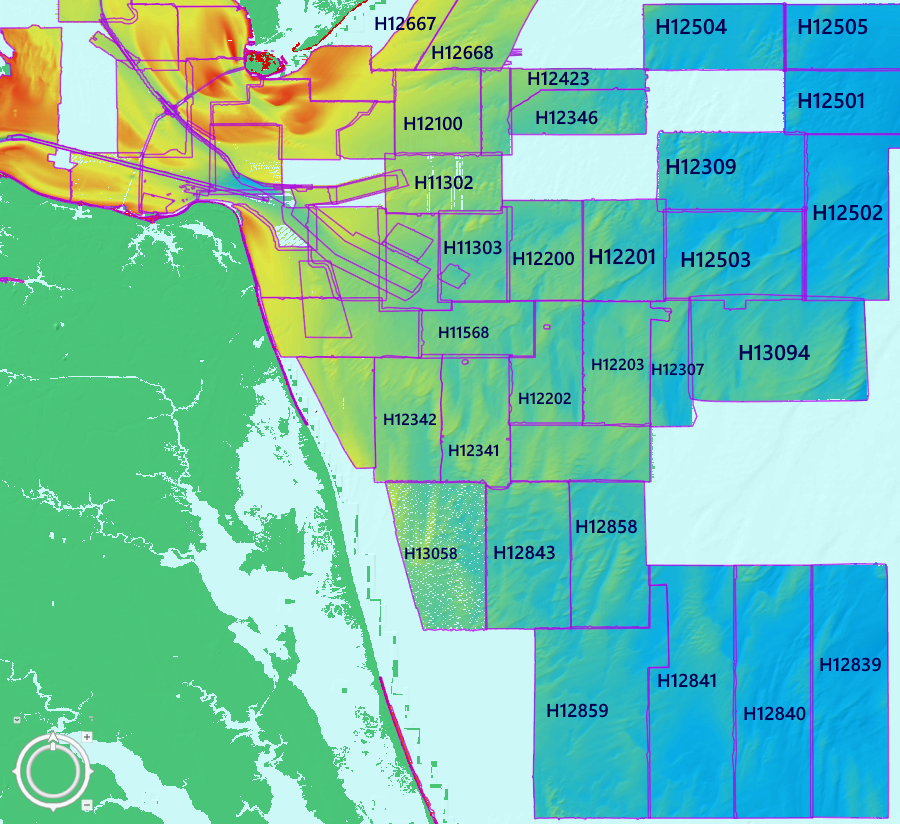

Here's a couple images how the bag bathymetry ColorHillshadeBAG processing template looked like before & after (whatever changes were implemented).

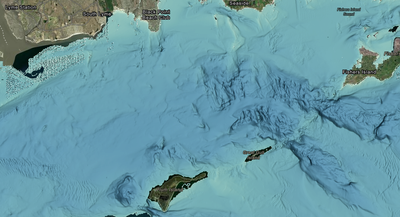

Accessibility issues suggest the need to change from classic 'rainbow' coloring, particularly for color-blindness. The updated colors represent western Long Island Sound, for example, without relying upon the traditional color scheme. NCEI Bathymetric Attributed Grid (BAG) Mosaic - Overview (arcgis.com)
The newer scheme also provides a great bathymetric basemap for display of other content for users' attention.

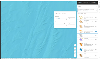

If you want to focus attention on the bathy layer itself, you might look at changing some of the display parameters (screen grab from ArcGIS On Line Map Viewer):

By changing the color hue, brightness, and contrast (try 212 on Hue, B=112, C=140) and Inverting that color scheme so shadows are white, I think you'll see features pop. This is how I used to do side scan sonar reviews.
