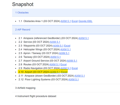

This exercise loads Airport data provided by https://aip.dfs.de/datasets/

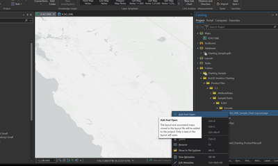

  1. Open a blank project and save. Download the project files referenced in below URLs referenced in the opening paragraph, then load the sample layout into your project. I ended up adding this folder as a shortcut in my project (Folders -> Add Folder Connection -> Sample Files Folder):

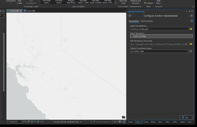

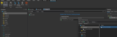

  1. Now, follow the instructions to build your Aeronautical Geodatabase. I converted this projects Default/Project database to the AIS database: https://pro.arcgis.com/en/pro-app/latest/help/production/aviation/set-up-an-aviation-geodatabase.htm
  2. Hop back over to the Enroute Template and follow the instructions from Step 6 onward to link your chart layout to your projects AIS database. On the Top left of this Catalog tab, notice that Items is currently selected. Click Workspace to update all layers to your AIS database at once. Be sure to click Validate and Apply.

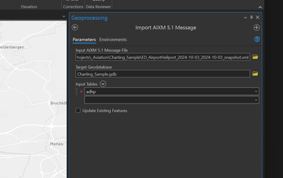

  1. Import Data: Now import our ADHP AIXM file since our AIS database is set up. In your geoprocessing toolset, go to Import AIXM 5.1 Message and select the downloaded sample file. Click Run: https://pro.arcgis.com/en/pro-app/latest/tool-reference/aviation/import-aixm-5-1-message.htm
If you navigate to Main -> ADHP and open the attribute table, it should be populated.

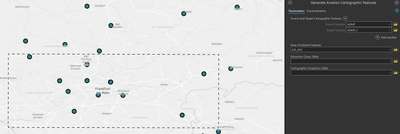

  1. Create an Area of Interest in Germany. I just drew a box around Frankfurt (i ended up making it much bigger than this example to get AD/HP and LS types), following the below steps: https://pro.arcgis.com/en/pro-app/latest/help/production/aviation/define-areas-of-interest.htm

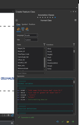

  1. The instructions point you to Generate Aviation Cartographic Features first, but I found you should create the Annotation layer first instead since generating new Cartographic Features populates the Annotation Feature Class. Be deliberate in following the steps up until Step 21. As a Note, Step 14 asks you to link annotation to the following feature class. Choose ADHP_C since our sample file uses Aerodromes/Heliports (ADHP_C): https://pro.arcgis.com/en/pro-app/latest/help/production/aviation/create-annotation-feature-classes....
    1. Step 21 says to add the label classes you want to use for the annotation features as a note. If you’ve set everything up right (including step 14/15 so the label classes do not error out with a Main_Info field error), go ahead and copy the code from the adhp_c_label_arcade_icao.lxp file in the charting tools and add it to the Class 1 Label:
Complete the Configure feature-linked annotation feature classes section, pasting the sample code provided in the instructions in the rules section

  2. Generate features first. In the Geoprocessing toolset set your source to ADHP (Mine was Main/ADHP). And the Target to ADHP_C. I opted to keep it simple and only include things within the Area of Interest drawn.

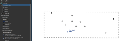

  1. This should produce something akin to the below (my final product will differ a bit since I messed around with additional symbology and annotation classes for Landing Strips and Helipads a bunch.

Note 3: If you want to annotate more things like the HP and LS records, during the Annotation Feature Class creation step where you can click the Pencil and update Class 1 to the adhp_c_label_arcade_icao expression, Scroll down and just change the “AD” to “HP” or “LS” to create new classes. You can also add them to the Array as 1 class if you want. I kind of liked having 3 individual Classes for toggling.
