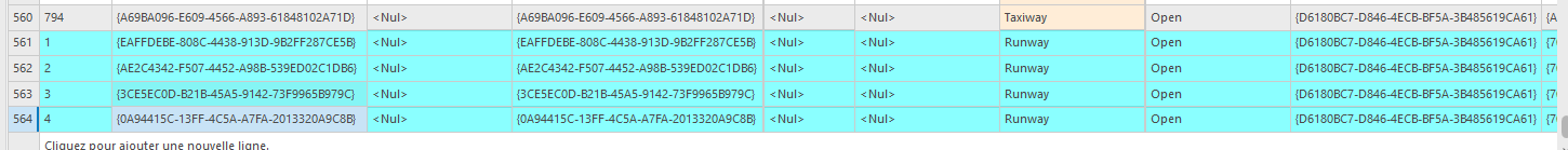

I have AMDB data, I have created an aviation database with the tool in AIS format.
I have started to fill in some data in order to carry out some tests:
- ADHP
-Surface Area (Runway)
- Surface Element (Runway Element)

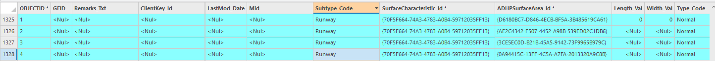

In the SurfaceAreaID field, I put the GFID of the runway entities in SurfaceArea.

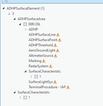

In the AIS database, when I select a runway element, I have all the active relationships.

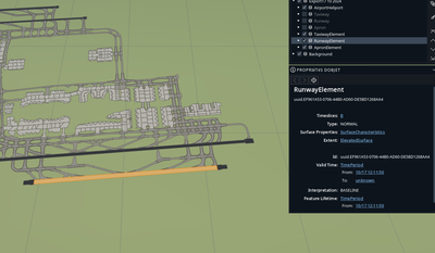

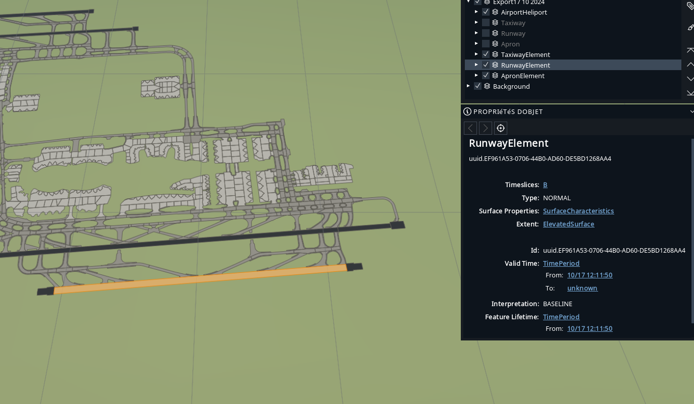

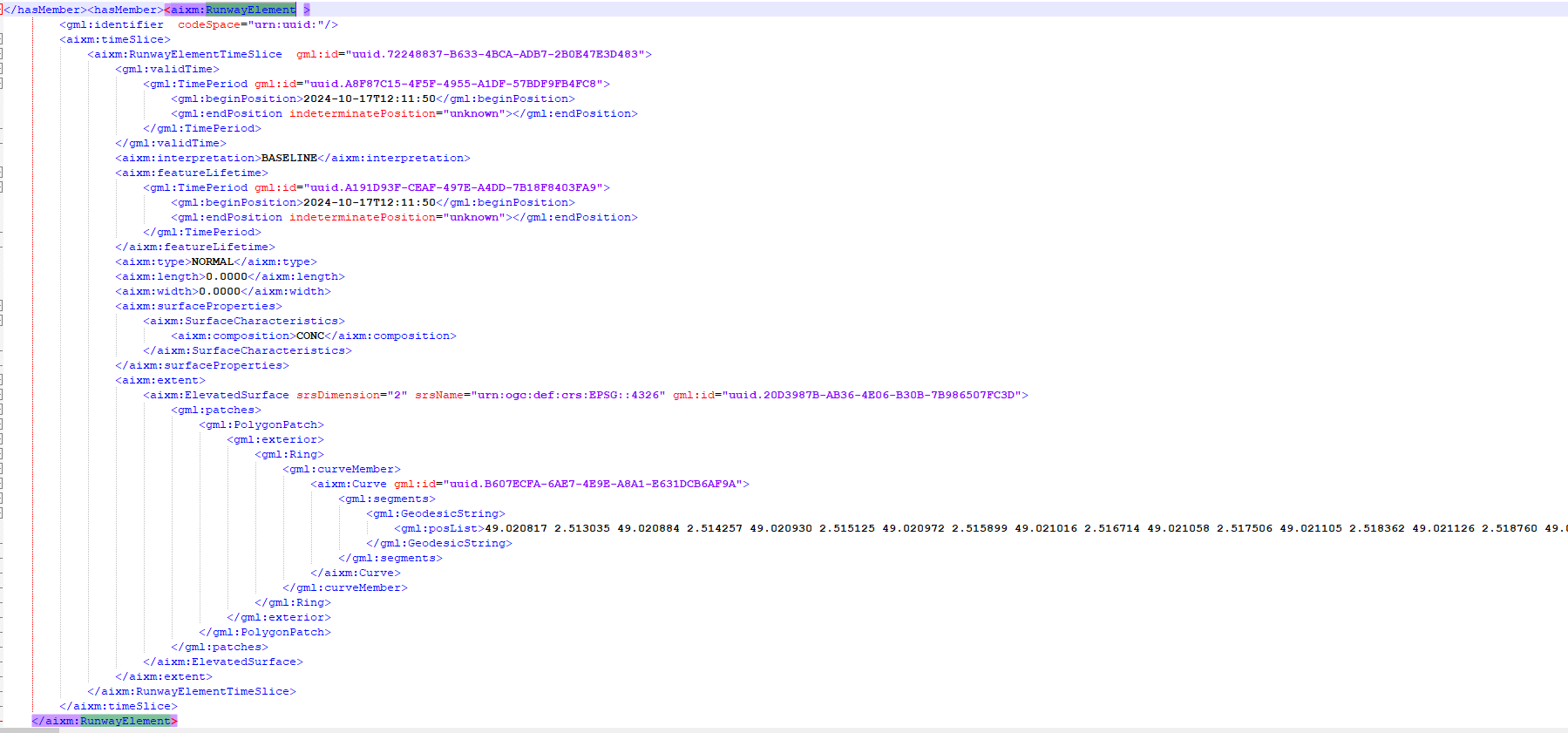

All's well in the best of worlds at the moment, but when I do the AIXM Export and try to open it on a AIXM viewer (Luciad). I can't see the relations between my features...
in the xml file, I don't see all this information either, so I imagine the problem is with the export, but I'm really having trouble understanding where this could be coming from. I've looked at the different files (Export template, ExportRelationships.json), I even tried to force the Keyclient_ID field
The export does a good job of making the link with the characteristic Surface table, but I have to confess I don't understand what I'm missing.

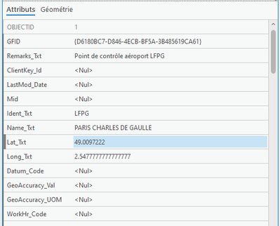

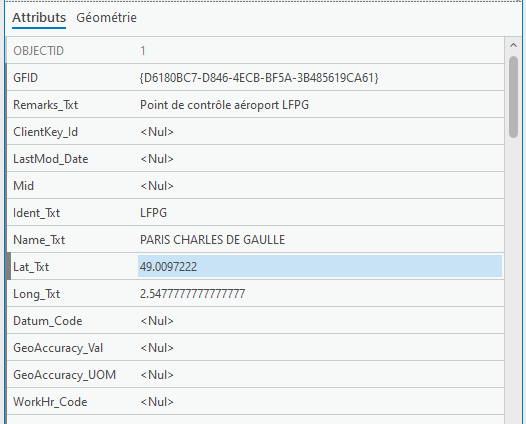

AIS gdb ClientKey_ID fields are used as the source for persistent AIXM gml:id values for AIXM features and some AIXM objects.   The Import AIXM 5.1 Message tool populates ClientKey_ID values in the AIS gdb with these from AIXM and the Export AIXM 5.1 Message tool populates these to exported AIXM messages.
I looks like your data may only need to have ClientKey_ID populated with unique values for the Export AIXM 5.1 Message tool to populate this property in the exported message.
The 51ExportTemplate.xml has this templated:
Output should look like this:
Search for clientkey_id in the 51ExportTemplate.xml for all the AIS sources which should have ClientKey_ID populated for full export.
