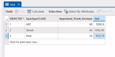

AlfredBaldenweck
MVP Frequent Contributor
It worked for me? Best guess is you just don't have any values in the API field for the other two, or the value is 0.
