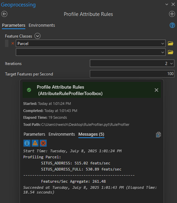

Example Output:
Attached is the full PYT file (the forum won't allow pyt uploads, so just rename the py to pyt)
