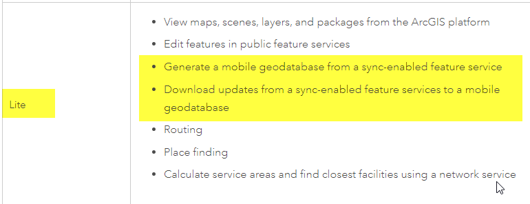

It looks like generating a geodatabase is possible with the Lite license and syncing changes is avaialable with a Basic license. I'm using this as reference: License your app—AppStudio for ArcGIS | Documentation

OK it appears that you can (with a lite license) create and download download updates....
I see there is a "Generate Geodatabase" from the samples in AppStudio
I can populate from Service as stated above but this is ONLY temporary and gets removed if you leave the page.
I can use the Generate Geodatabase as mentioned above but creates a new geodatabase every time you hit the button...dosent look like that option works for syncing to the same geodatabase.
Does anyone know of an example out there that looks for a Geodatabase, if not creates one, and then allows the user to store this geodatabase when they leave the page or app.  But also allows then to click a button and update/sync any new features that were created since they last downloaded it.  (NOT creating a new geodatabase each time?)
  • Generate a mobile geodatabase from a sync-enabled feature service
  • Download updates from a sync-enabled feature services to a mobile geodatabase
