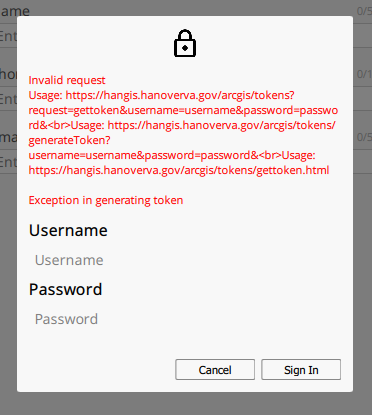

but I get this error:
I can get the app to work by plugging the username and password into this line in FeatureServiceManage.qml under the generateToken function:
var obj = {"username":"username", "password":"password", "f":"json", referer: "http://www.arcgis.com"/*, expiration:"1"*/};
But my guess is that’s not how it is supposed to work. Am I missing something?
