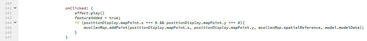

RaulLeos
Hi Erwin,
I am not able to capture data and getting this error message. Need help
MyApp.qml:243: ReferenceError: positionDisplay is not defined
ErwinSoekianto
Esri Alum
Raul,
I think positionDisplay was available in ArcGIS Runtime version 10.2 Position display—ArcGIS Runtime SDK for Qt | ArcGIS for Developers , but no longer in version 100.x , Migrate to 100.x from 10.2.x—ArcGIS Runtime SDK for Qt | ArcGIS for Developers
You should remove or replace it with the library that is available in version 100.x
Thank you,
Erwin

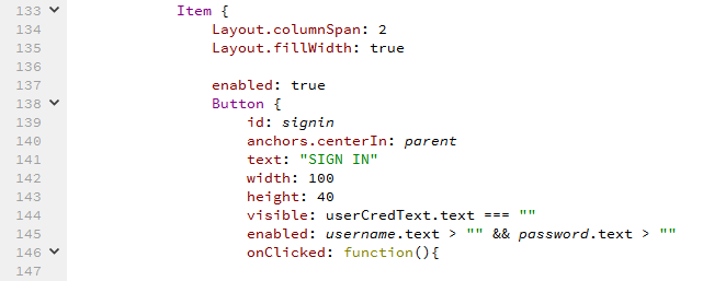

RaulLeos
Hi Erwin,
Here again, I was able to build application with some referenceErrors.
On executing the Mobile App
First one - userCredText is not defined
 Second - Unable to assign [undefined] to int
On performing field collection I get this
Cannot read property 'x' of undefined
Your assistance will be greatly appreciated.
