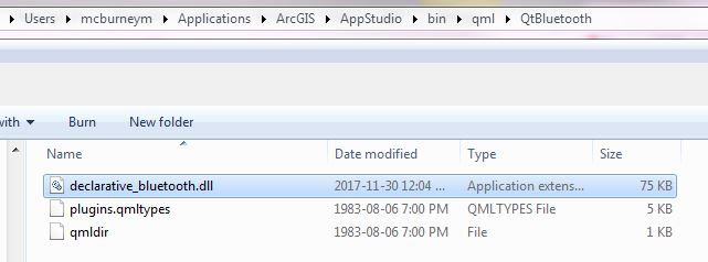

If you are on Windows, can you check this path on your computer, C:\Users\<username>\Applications\ArcGIS\AppStudio\bin\qml\QtBluetooth ? Do you have "declarative_bluetooth.dll" ?

Neither, i am using Windows 7. And i can confirm, i do have the declarative_bluetooth.dllbluetooth.dll

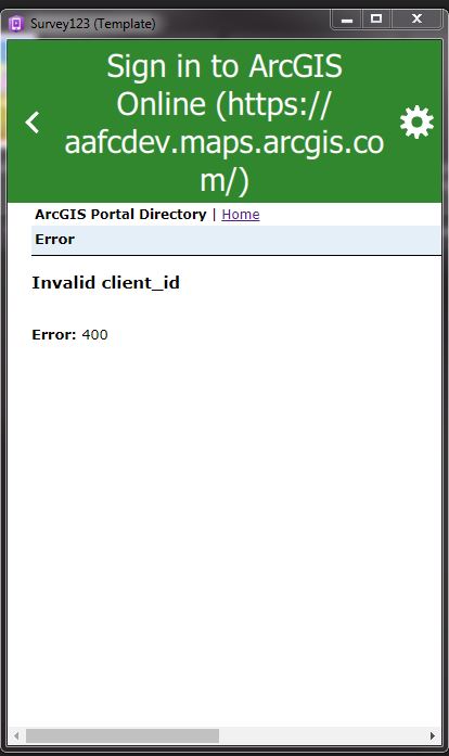

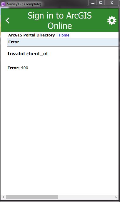

While the Bluetooth error has stopped and the Survey123 app launches I have a new problem. As you can see in the images below, it will not connect to the generic or my org AGOL. I also get a message that AppStudio has failed in someway after my attempt to use the app (this does not happen when using other templates in my account).

With the help of Tom from Esri Canada I think I have it figured out! I am now in Survey123!
"So I believe I've resolved the client_ID error message, this is because the default application you've generated is not actually part of ArcGIS Online yet, so there is no client_ID associated with it. To resolve this problem, follow the steps below:
  1. In AppStudio, on the Survey123 Template, select the Upload button.
    1. This may take several minutes
  2. Once uploaded, still within AppStudio, select Settings.
    1. This will open the settings for the Survey123 template
  3. In the AppStudio Settings menu, select Advanced...
  4. In the Advanced Settings menu, click on the Register button
This will generate a client_ID for your application within you ArcGIS Online Organization, allowing you to sign in properly through the viewer."
