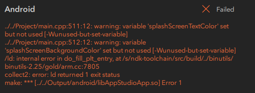

I have an app based on the quickreport template 10.2.7, which has been customized(some functionality added, and some functionality removed). When i try to build the app using Appstudio for Desktop(cloud make) i get the following error:

Hi Kamran Yusaf‌,
I believe you are using AppStudio 2.1 since your app uses the 10.2.6 ArcGIS Runtime. I checked the build logs on our Cloud Make build servers and can see that the build request for your app has failed with the same error you get with Local Make.
qml: /ld: internal error in do_fill_plt_entry, at /s/ndk-toolchain/src/build/../binutils/binutils-2.25/gold/arm.cc:7805
Please note that AppStudio 2.1 uses Qt5.9.1 for building apps in the Cloud Make build environment. We do not support building apps with Qt5.11.1 + Local Make + AppStudio 2.1. Qt5.9.1 has to be used with AppStudio 2.1 + Local Make
However, the build error does not appear to be related to the Qt version used. The build fails when linking due to an increase in the App binary size. Were any new files added to the app recently?  Can you try removing unused images / reduce image size and try building again?

Hi Shobana,
It is workning after i deleted unnecessary files from the app.
