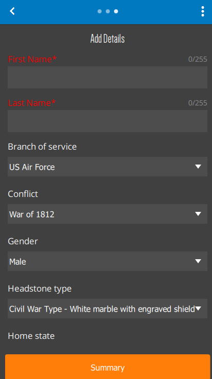

When I get to the page for adding details for the point features I ensured were not allowed to be left null, are in red and have an asterisks next to them notifying the user that input is needed for those fields.
The problem is when I submit the form with those fields left blank, it proceeds and submits the form. How can I fix this?

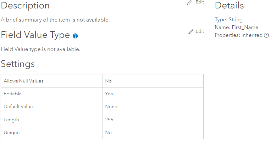

Can you verify that the fields in the feature layer are required?

Hi, thanks for the reply. Here are a couple screenshots. First is the app info page, you can see in red those are the two fields that I need to not be left blank. The second image shows the first name field is not allowed to be null, which is the same case for the last name field.
