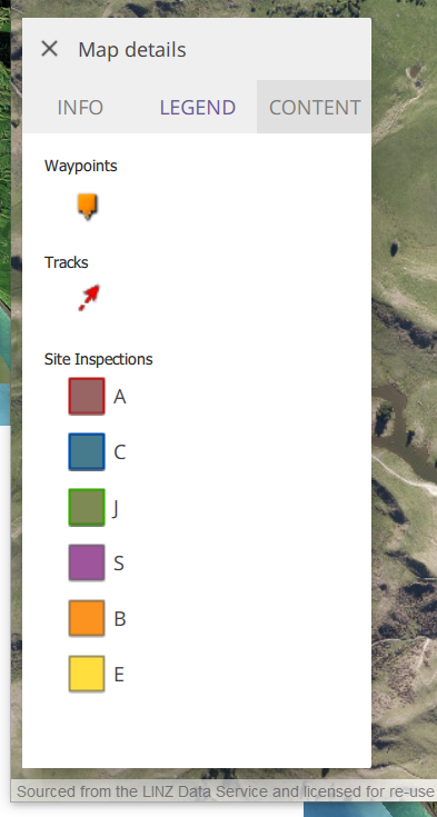

e.g. this is the actual web map symbology

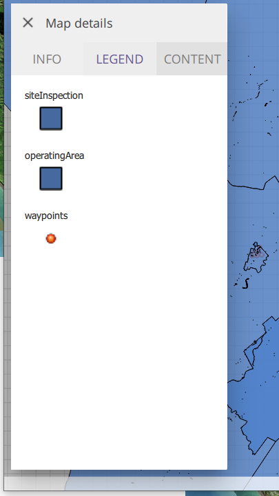

whereas the offline map area seems to default to the feature service symbology:

The webmap in ArcGIS Online Map Viewer,
Webmap in AppStudio Map Viewer with the same Layer name and symbology.
Offline Map Area in AppStudio Map Viewer (see the points has plain black symbology and the layer name is not the same as in the webmap)
