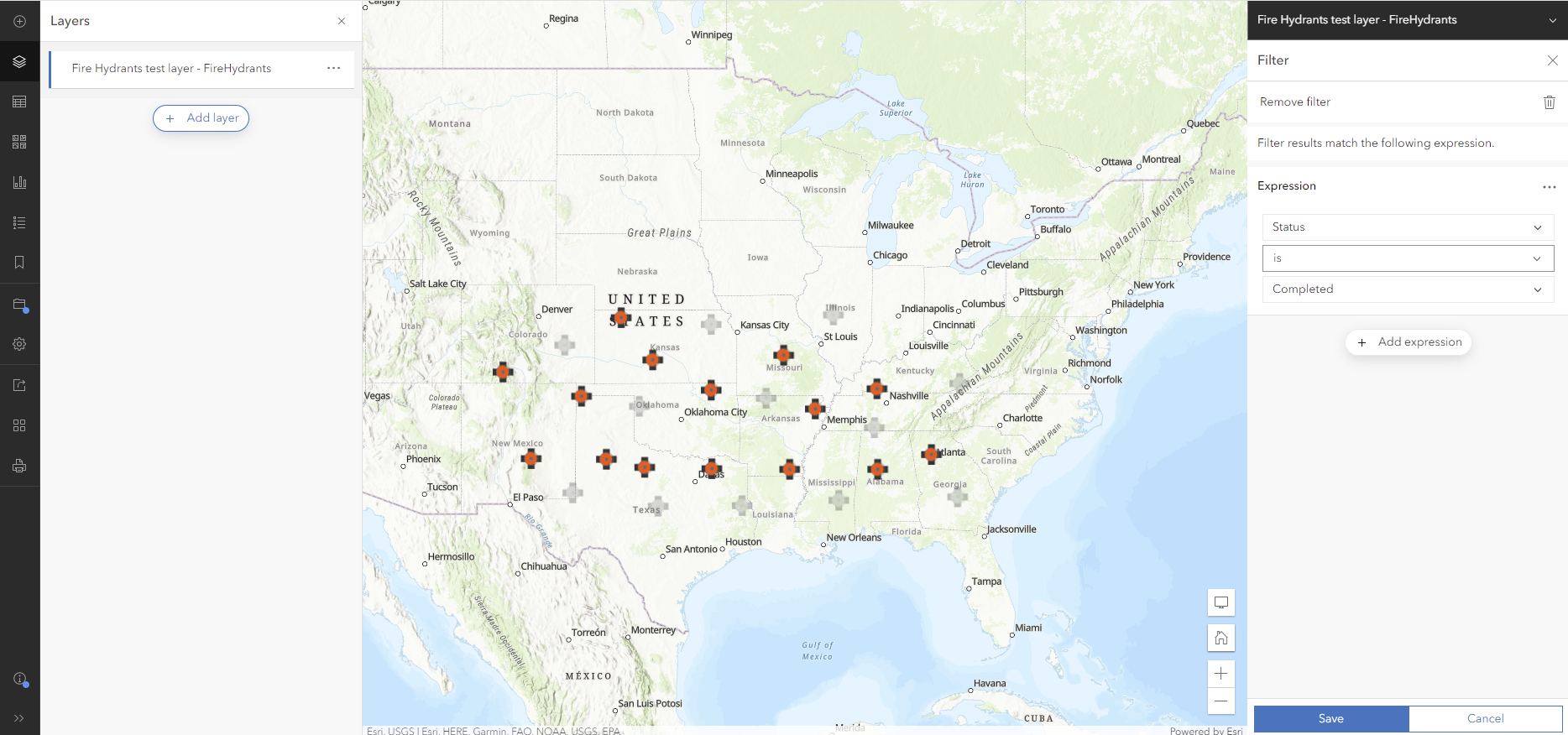

For a visual representation of this, see below.
A screenshot of my webmap in ArcGIS Online that shows the filter correctly applied:
