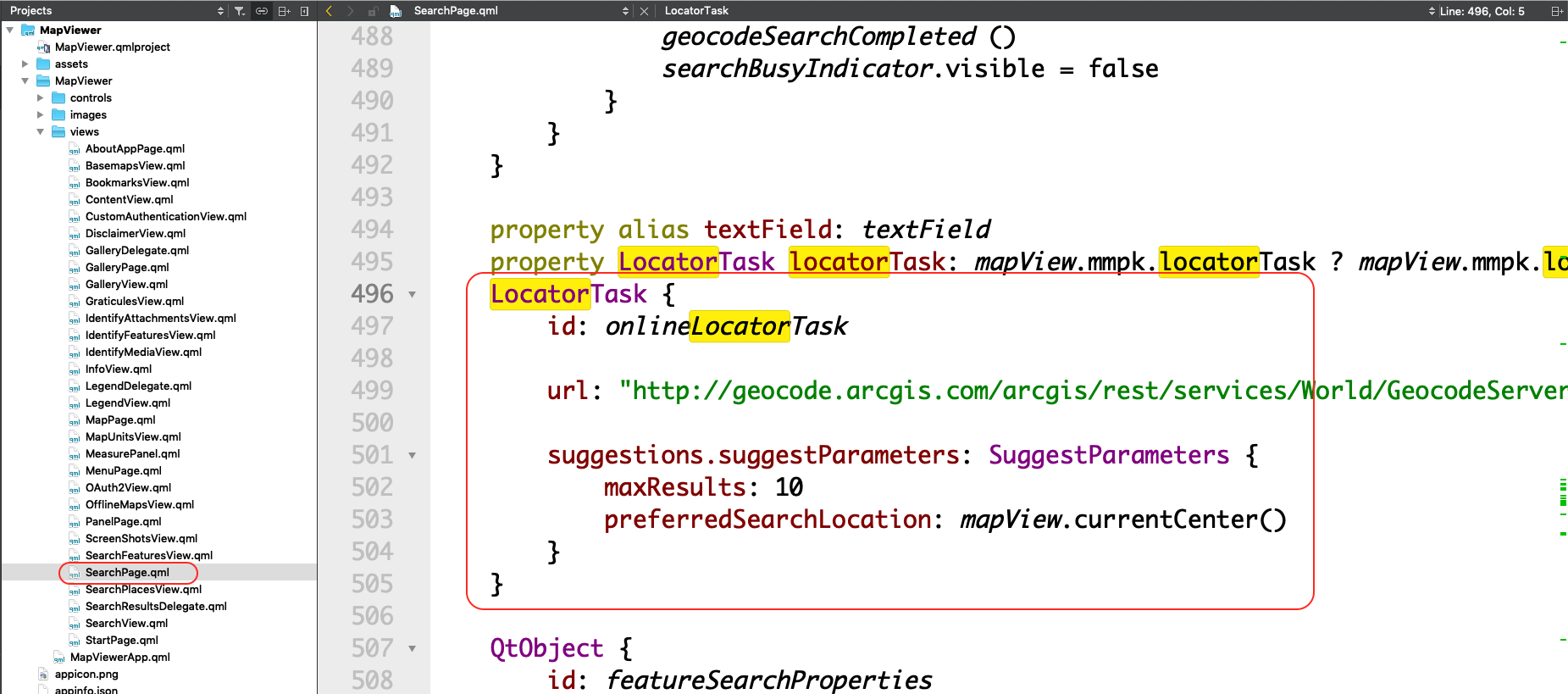

Ryan,
At this point, we are using the Esri World Geocoding service by default. This is a great enhancement, that we will bring it up to the team, to be added as either configurable property on the setting page or automatically using the locator of the Webmap.
With that being said, you can change the source to change the URL of the Locator Task to your own for now, on MapViewer/views/SearchPage.qml around line ~500. See below,
P.S. Click on the "Edit" menu option in the AppStudio Desktop to go the source code the app.
Thank you,
Erwin

Thanks Erwin!  Worked like a charm!

Can you happen to use 2 different geocodes? How would you script that in?
ErwinSoekianto
Esri Alum
You would have two LocatorTask QML objects, with two different ids and switch them around as the user selects it from the UI.
