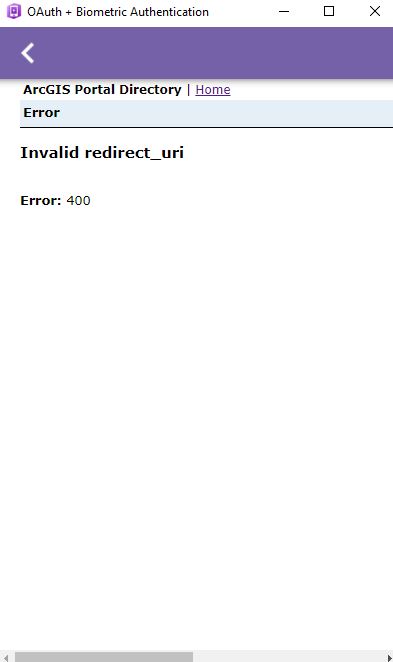

Good Day,
I am trying to use the OAuth + Biometric Authentication sample app. To do so, I registered a test app, got a Client ID and used that Client ID as prescribed according to the description of the sample app.
"If you wish to use the code from this sample app, please update Client ID with your own at MyApp.qml file, line 109"
I got the error below. How can I fix this? (P.S. I am not the ArcGIS organization's administrator etc. so I can not do any type of changes)
nakulmanocha
Did you register it from AppStudio desktop app settings or directly on the developers.arcgis.com? If you did it on developers.arcgis.com please add the redirect uri - urn:ietf:wg:oauth:2.0:oob as mentioned in the following help
Sign your app—AppStudio for ArcGIS | ArcGIS
Nakul
nakulmanocha
Nakul
GiatriLalla
Thank you! This works perfectly! I registered via developers.arcgis.com and after adding the redirect uri it worked.
I wish I found this piece of help earlier on. It would have saved so much time. Thank you again!
