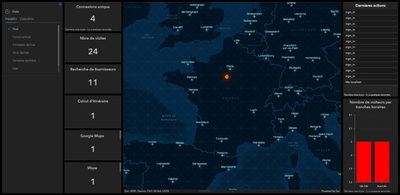

conde
Thank you @ErwinSoekianto . I'm going to try that
conde
I finally did a POC using AnalyticsManager. It's quite interresting for app analytics management.
