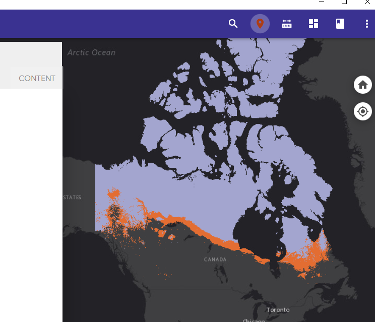

Thanks - here is the service i am attempting to use. It is not a mosaic dataset on the back end. It's a standalone FGDB raster (with an attribute table).

Hi Mattew,
This is what I see in Map Viewer, we are currently working with Runtime team to confirm if this is a Runtime bug or not.  I will keep you updated on this issue.

Yes, that is what I am seeing as well. I should also tell you that another imageservice we have seems to render as expected.
