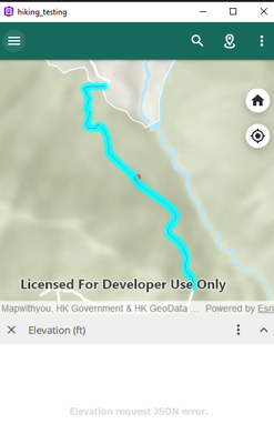

  • Map Viewer – Elevation profile support for polyline features
and from
https://learn.arcgis.com/en/projects/configure-apps-for-hikers/
that a trails can have elevation profile.
However, in my case, I created some trails and published it. I also made a webmap and nearby webapp from it.
Then I try to build a mapview app and nearby app from Appstudio.
It fails to load the elevation. What steps should I take to make it works?

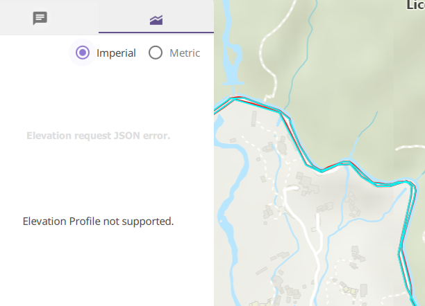

Hi TrevorFrame, when I went through the lesson, there is no problem with webmap created by the instructor.
However, when I replace the webmap by my own. The elevation profile fails to show up.
my feature layer: item.html?id=a7a1af264013488185fb8c8989c1a070          (Feature Layer, public)
my webmap layer: item.html?id=db8454b1073b44cb947e9e2edd42acb1   (Service Definition, public)
my nearby webapp: appid=bff20cdf1ff14eb181da1f6d09098d11                (Instant App - Nearby, public)
[I can view the elevation profile in webapp, just cannot view it in app made by appstudio]
my appstudio app: item.html?id=5191bc5a63a142c8ba528c2ab9911220       ( Native Application, public)
Thank Trevor for your active assistance. I shared the app as public. I don't know whether you can download the app since I cannot see a download button in arcgis online. Please contact me if you cannot view it.

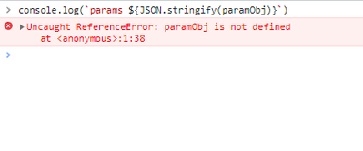

Hi Trevor, I am not unsure how to do that. Is the cmd typed in F12 console in a web-browser or elsewhere?
1. I tried In web browser, what paramObj should I defined in order to view the parameter?
2. Is there any console for debugging in Qt editor that allow us to use that command?

As for the console.log() statement as stated above, it would go inside your QML code using the Qt Creator editor. You would have to navigate to the /Nearby/views/ElevationProfileView.qml folder, then around line 839 is the fetchSummary() function. You can add the console.log() statement anywhere under the variable declaration of var paramObj around line 849 ( I added mine just below it). Check the screenshot below for a visual of it. You can see the console logs out in the "Application Output" tab which is at the very bottom of the window. Screen Shot 2022-06-14 at 8.36.54 AM.png
