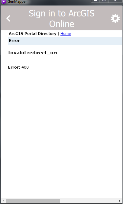

How do i define redirect uri for appstudio App registration? Is the error 400 due to this while login the app?
1584
08-28-2017 01:03 AM
GeoDevPathways_Data
["https://<server>[:port]"] or ["http://<server>[:port]"]
we are assuming server is our arcgis organisational landing page but what is the port?

We have provided the app ID, but we are unsure about what the redirect uri is. Does it automatically provides the uri once the app ID is provided.
nakulmanocha
Can you please try using this "urn:ietf:wg:oauth:2.0:oob" for redirect_uri when registering your app in your org account?
GeoDevPathways_Data
I tried this and it worked out. thanks man.
