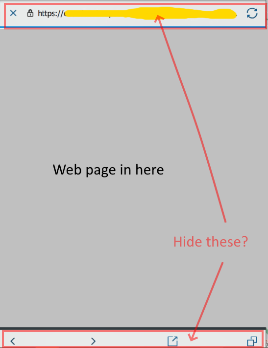

Anyway, for consistency sake, our only option is then to use a BrowserView, but the question I have is - is there any way of getting rid or hiding the 'furniture' around the web page that displays. We don't want the users to navigate away from the fault reporting page or from the app itself.
Essentially, we want to hide the blocks highlighted in red at the top and bottom of the page:
Best regards
Terry

Terry,
This is a great suggestion, but I don't think we have special properties for it.
But I think you can achieve this by adding anchors.topMargin and anchors.bottomMargin to negative value to workaround it.
BrowserView {
             anchors.fill: parent
             anchors.topMargin: -40
             anchors.bottomMargin: -40
             primaryColor:"#8f499c"
             foregroundColor: "#f7d4f4"
             url: "https://www.esri.com/en-us/arcgis/products/appstudio-for-arcgis"
Thank you,
Erwin
