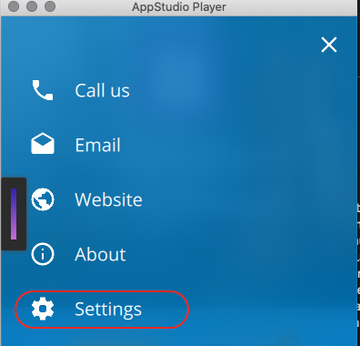

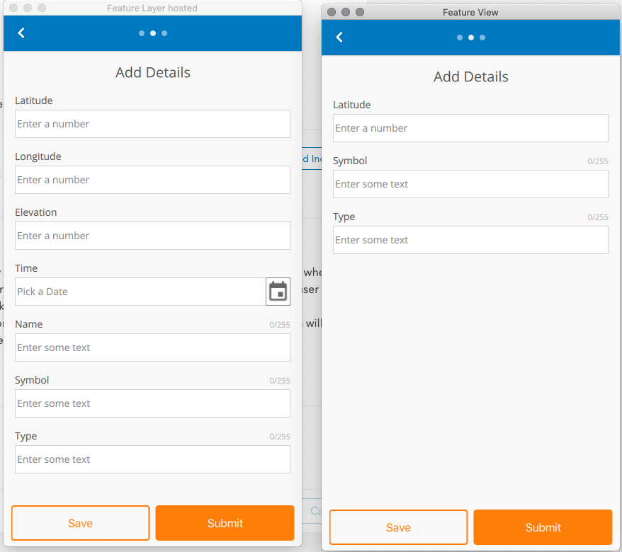

I can not reproduce this issue, I am able to use both hosted feature layer and the hosted feature layer view, and only show the fields that set to be shown on the respective layer.

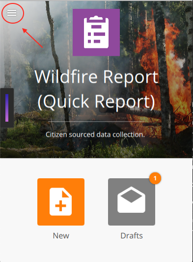

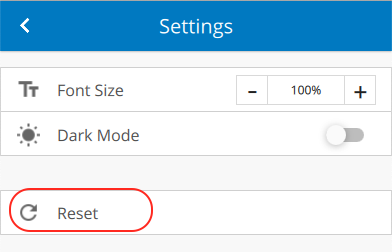

Perhaps, if you are using the same app you need to Reset the app to make sure to get the latest changes from the feature layer schema? Go to "Hamburger" menu > Settings > Reset.
