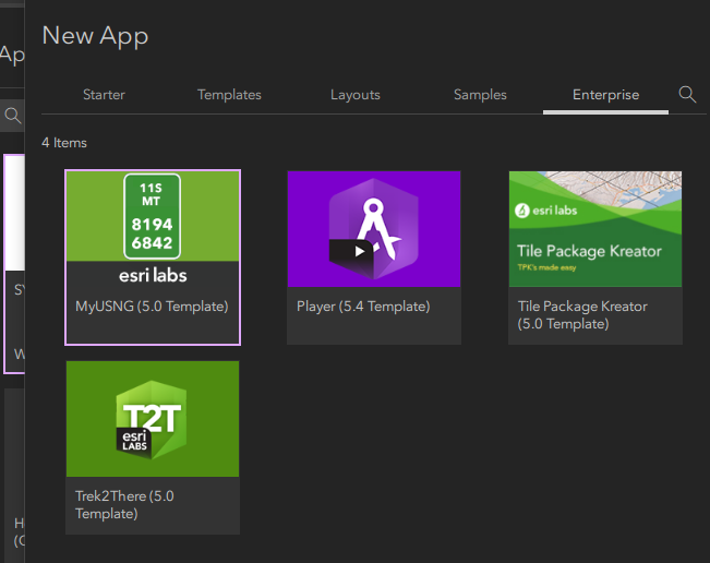

Hi. I recently purchace the licence ArcGIS Developer Subscription (Builder Plan)
The arcgis dev test and admin account were created and configured. Opening the ArcGis AppStudio 5.4 I can not see all Enterprise Template.
Some months ago, I was using another account and developed a tools using the Survey 123 tremplates. But with this account the Enterprise templates not shows.
What can be wrong ? Any updates done from Esri ?
thanks
Crisjovano
TrevorFrame
Hi @CrisjovanoGumaraes
As of February 2022, the Survey123 enterprise template is no longer available to access through AppStudio. You may submit a survey form here to request access to the source code. Please make sure to read the information at the top as it contains important information.
