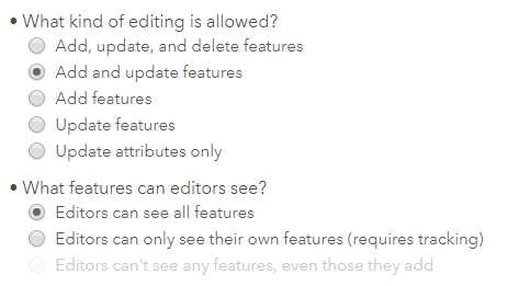

Are there any plans for Quick Report to support the feature layer edit settings below - with attachments enabled. I understand that Survey123 supports attachments with this particular editing configuration.
Currently I cannot add attachments unless 'Add and update features' is selected, which disables the 'can't see any features' option.

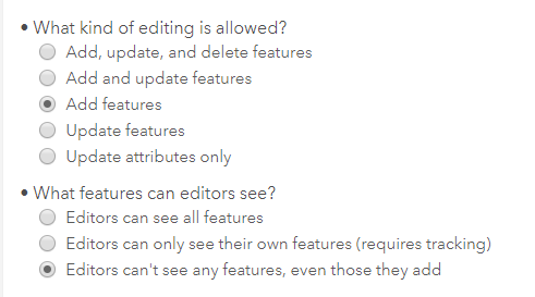

This is the setting for it to work,
We are currently looking into this, to see if we can make it work with "Editor can't see any features, even those they add".
