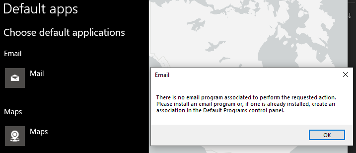

I am wondering that is there any condition that working properly of Email Composer? I supposed to it will work on Windows, but it returns an error even I'm using windows default email client which is associated in settings' pane like below. I've also tested using Mozilla Thunderbird but failed.
Does someone have a knowledge about this?
Thanks,
Sean.

Yes, I can reproduce the same issue that Email Composer from AppFramework of AppStudio for ArcGIS does not work with the default Mail email client app in Windows 10. However, I can make it work using Microsoft Outlook email client. Do you have option to install Microsoft Outlook on your end?
I tried to install Mozilla Thunderbird on my side, but I am having trouble setting up our mail server, however the Email Composer does trigger to open the Thunderbird application.
