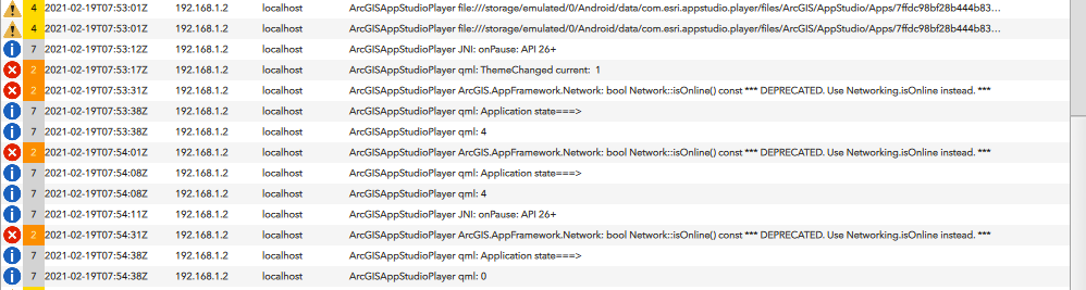

i am trying to get state of application in qml
console.log(Qt.application.state);
but how to make gps work on 2 states active and hidden. when  it is active it return 4 and when i close the app with middle button. it return 0, and i have to make gps  working in both state.
How to do it.
Thanks in advance
 i have enabled the location in capabilities in background modes.
