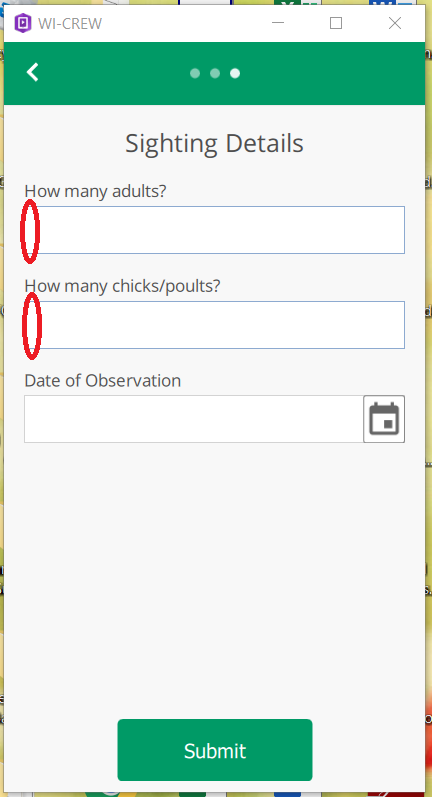

To enter data in the 'How many adults?' or 'How many chicks/poults?' fields (both are integer values), I either have to mouse over to the far left edge or on my phone, tap the very left edge with my finger. Is there a way to change the settings in AppStudio so that you can select anywhere in the textbox to enter your value?

Hello Jessica,
This is a known issue in Quick Report 4.2 and it has been fixed in version 4.3. You can also implement the fix QuickReport/controls/EditControl.qml line 150, you need to add "width: parent.width"
Thank you,
Erwin
