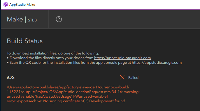

Have an app developed using AppStudio for ArcGIS 3.1.134. Was able to successfully generate an ios build using cloud make at end of last month. Tried to generate a build today but this failed due to an expired developer certificate. I went through the usual process to update STBB with a new certificate, but the cloud build is still failing but this time with a different error (in attached screenshot).
I can't work out if this is an issue with how I've regenerated the cert or updated the STBB config, but this is a process I've followed before without issue. I'm not receiving any build notifications from cloud make so don't have any further details to go on.

When I inspected my provisioning profile in the iOS Dev site, I verified that the new certificate was selected and the profile was for development. But I did notice this message next to the new certificate "For use in Xcode 11 or later" - wonder if that could be related?
Any thoughts would be appreciated.
HeathcliffRongo
Turns out I needed to select iOS App Development not Apple Development when creating the new certificate in the iOS Dev centre. Not sure how I missed this considering I've been looking at the page at least half a dozen times today, so feeling a bit stupid.
Repeated the process above with a new iOS App Development certificate and now the cloud make works.
