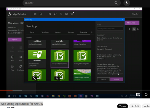

I am doing some test regarding Appstudio and extend survey123. I was watching this video on youtube " Extending Survey123 Field App Using AppStudio for ArcGIS" and there they clic new app, then click enterprise and there they see survey123 template
on youtube demoon youtube demo

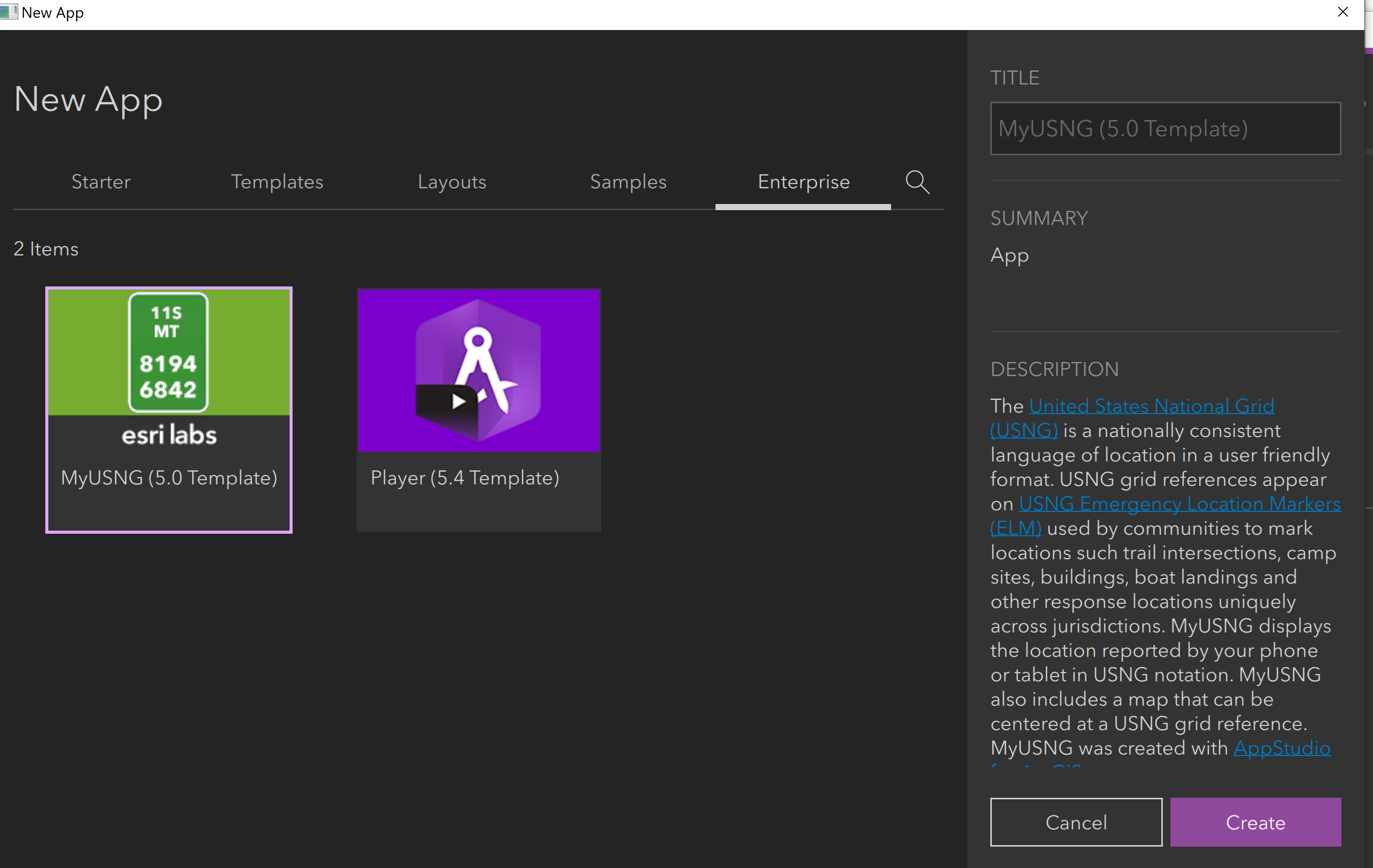

and when I replicate that on my computer, I do not see survey123 template
I sign in to appstudio using my license from arcgis Online and AppStudio 5.4, is there something else that I need to do to be able to use survey template?

Hi @DiegoLlamasOlivares,
As outlined in the What's new in ArcGIS Survey123 (February 2022) - Esri Community and What’s new in ArcGIS AppStudio Version 5.3 (March 2022) (esri.com) the Survey123 templates are available upon request by completing the following form: AppStudio Enterprise Template request form (arcgis.com)
Note that the current Survey123 3.14 template available in AppStudio is only officially supported in AppStudio 5.3. Whilst it may work with 5.4, it is not supported and there may be issues, as the 3.14 version of Survey123 was built with AppStudio 5.3, not 5.4.
