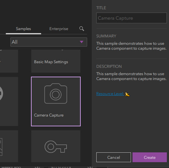

I took the Camera Capture template from AppStudio for ArcGIS and uploaded it.  I then went into Player on my phone and took a picture.  I cannot see that image saved anywhere.  I want to take this image and attach it to a feature with attributes but I first need the actual image to be captured....Am I doing something wrong?
Does this sample not capture and save to picture?  Does it place it in limbo or somewhere that I can then save it somewhere?  Sort of confused how this is working.  Any ideas?

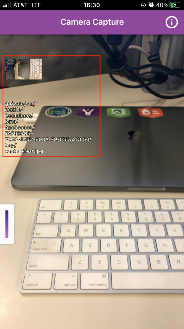

Jay,
The picture is stored at the path highlighted on the screen. See the image below.
Thank you,

I cant find the image anywhere on my phone after taking the image....will check again....

That path on iOS, /var/mobile/Containers/Data/Application/... is sand-box private application path. You can not just go to the location. But within the same application, you can refer to it using the path, and do things programmatically, such as display it and upload it as an attachment of a feature.
The same logic also applies in the QuickReport template where user can take pictures or videos, then upload them as attachments to a feature.
