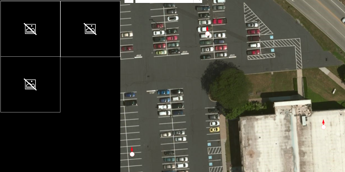

Hello all,
Did my due diligence and so far haven't found the answers.
I would like to create and app using App Studio's default template "Map Viewer".
However, whenever I click a point, the attachments (image/s) does not show up. Atrributes shows, just the images not showing.
The workflow is
Public Survey123 form submitted and visualized on a Web Map.
Web Map consumed by Operations Dashboard and this app.
Images show up in the Web Map and Operations Dashboard.
Thoughts?

gissdadmin
Hi Erwin,
thanks for the reply. There is nothing wrong with the Web Map as you have specified. The situation is the Web Map shows the attachments, and all the point features have photos. The Operations Dashboard consuming this webmap also displays the photos.
However, when I create an app using App Studio, the created app does not show the attached photos, just the attribute information of the points.
Basically what I want is when users use the app, and when they zoom in and click a point, the attribute info and photos are both shown in the app. Right now its just the attribute information.
__________________________________________________
2nd: Regarding Point Clustering, in the Web Map I have two layers right, same layer actually, but one is a layer that has clustering enabled. So in the web map and Operations Dashboard, clustering of points is shown.
However on the app I created using App Studio, the points don't cluster even though they are referencing the same web map.
thanks for your insights. Please see attached photos.

HarryFrank
